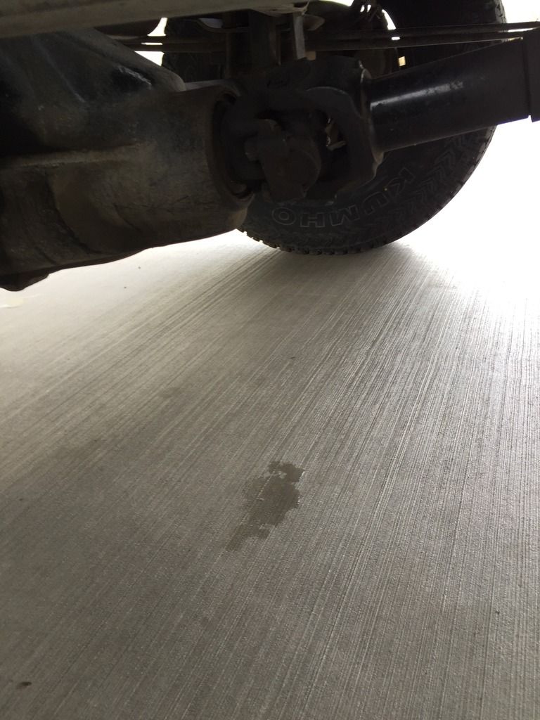

Classic limited bump travel - about 2 inches of shinny shock shaft.
Originally Posted by Jsweezy View Post
Classic Advanced 4x4 shock removal. Its how I knew it was done by them when I first rolled up.
Unless that is Power Steering fluid running down from the steering box, which I do not see, it is just a little residue from red grease that was put in the in the tie rod end zerk fitting. Wipe it off and see if it reappears soon.
Leaking
Unless I am missing something, I don't see any leaking or dampness around the pinion seal or running down the differential bottom, and the puddle on the ground is clear and looks like water - not thick dark gear oil. Put some on you finger and smell it - gear oil is unmistakable.

Hey Bajasportsmobile, thanks for taking a look at this stuff and giving me some insight. I will check that stuff as soon as I get back to the van. I am sure your right about the red grease residue on the zerk fitting because when I was under it last I noticed a couple other zerk fitting had the same thing.
