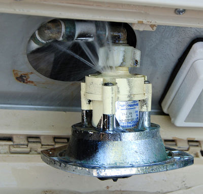

I just had the very same thing happen to me this winter:
Originally Posted by geoffff
We were out in the van for an overnighter recently, and we noticed that the water pump wouldn't shut off when water switch was on. The next morning, we found a big puddle outside -- and a big spraying leak from the water inlet (pressure reducing valve).
There's a big crack in the plastic. Perhaps another casualty of winter freezing?
The part is a "Shurflo Water Pressure Reducing Valve", model 183-020-04 (50 PSI). My local RV shop doesn't have a exact replacement, but sells 183-029-18 (65 PSI) which looks like it'll fit.
-- Geoff

We had a very similar leak in our Sprinter as shown in Geoffs photo. The leak occured earlier this spring during our first year of ownership. The plastic area near the threads looked old, wrinkled and weathered and I would have thought a leak caused by freezing would have created a cleaner crack in the plastic? SMB-Fresno replaced the unit while I had other warranty work completed.
