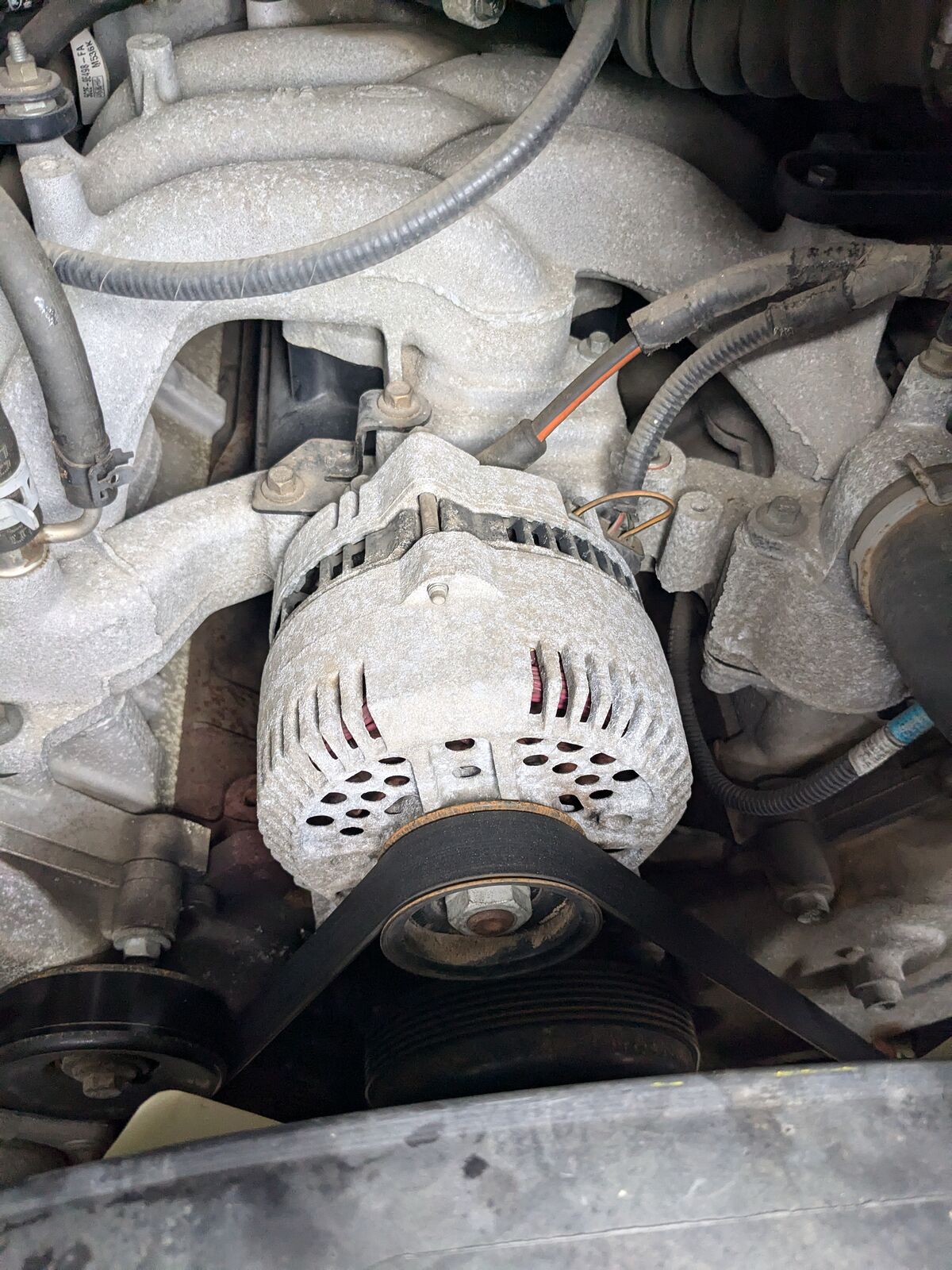

I installed a 250 amp alternator from Tucson alternator exchange. The first one they shipped I didn’t notice it had the wrong pulley, and it ended up slicing a section of the $80 belt off. They sent me a replacement and when I received it I noticed it only had two mounting bolts, with no provision for the stock Ford third mounting bolt that uses a bracket on top. I questioned them about that, and they said They don’t offer one utilizing three bolts But they’ve never had a problem. Fast forward five months, and the two mounting bolts both broke after an extended period of time at high rpm’s while climbing a steep mountain pass. This caused the alternator to fall off and spit the belt. After a $400 tow I was able to remove the two broken bolts from the manifold, and find two used mounting bolts to hopefully hold the alternator in place until I can replace it with one utilizing three bolts.
arctictraveller> That's terrible! I'll make sure mine has all 3 bolts!
kbeefy > Singer sent me the exact same list when I asked about my gas V10 engine. Hmmm... that's weird. I will have to call them to make sure the number of bolts is right.
Mine has 3 bolts, I don't remember what the mounting differences are for the v10.
I think I may have seen the oversize cases use fewer bolts for fitment.
Does the v10 have 2 bolts underneath going aft and one at the back going forward?
Totally different mounting from the diesel.
