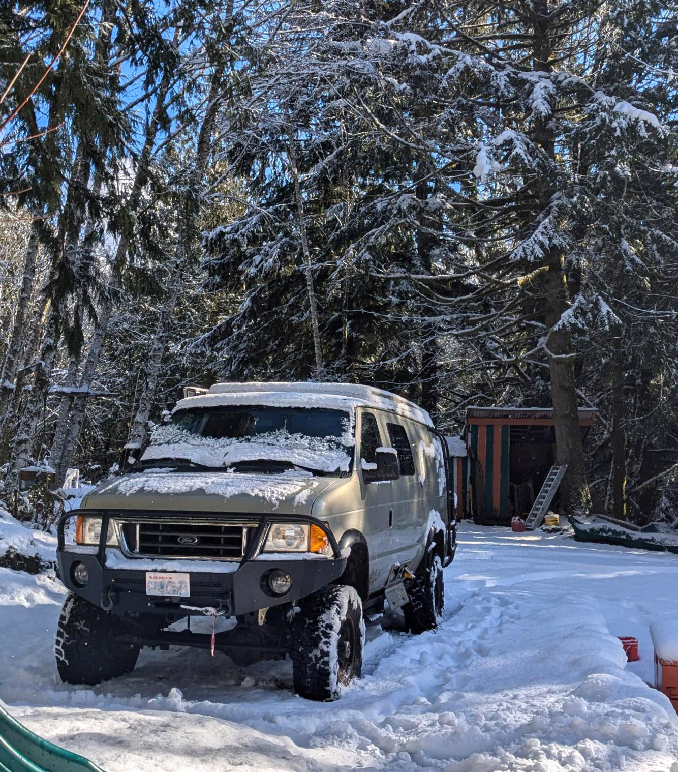

I recently took my van out into the woods, and it barely made it up a steep quarter mile access road covered with fresh 6-inch wet snow, just below freezing. (Next time I'll bring chains!!)
But (even scarier) it barely made it down the hill again later without sliding off the edge into the trees!
I would move downhill a few feet at a time, brakes engaged, as slow as possible, and the rear would always start swinging out sideways. Luckily the van would come to a halt within a second or two when I mashed the brakes. I would then let off the brakes, rolling for a second or two in order to straighten the van out, before gently applying them again to keep the speed to a crawl. I repeated this process all the way down the mountain. I don't remember hearing or feeling the buzzing of the ABS.
