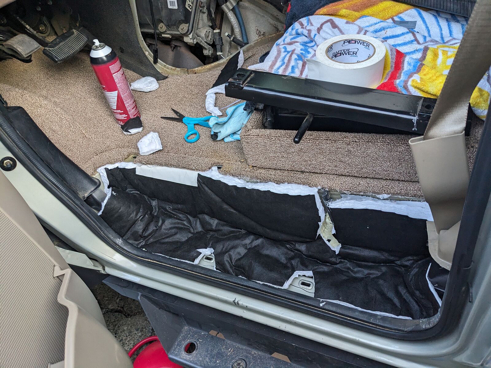

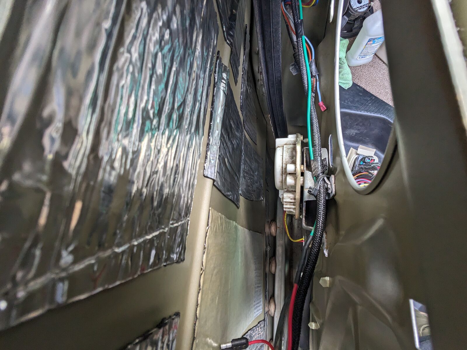

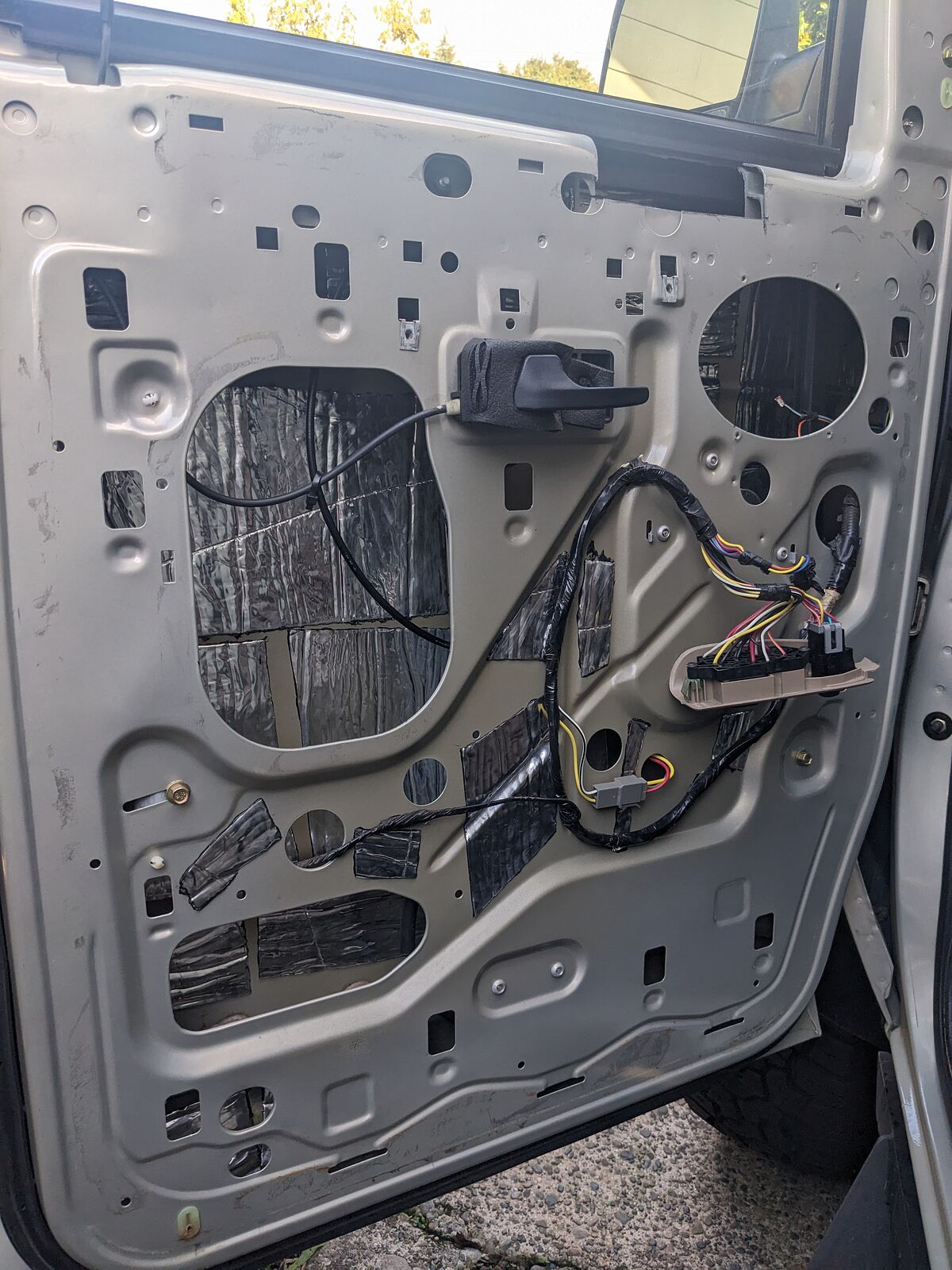

Then as I was screwing plastic into plastic into sheet metal (thanks Ford), I thought "gosh, this is only going to rattle like crazy even more than it already does." So I decided I was going to line all six doors with sound deadening. I ordered the "Kilmat" self-adhesive 80 mil butyl & foil sound deadening sheets. This stuff:
https://www.amazon.com/dp/B0751CBXBT?psc=1&ref=ppx_yo2ov_dt_b_product_details
Did all six doors with plenty leftover.
Results so far:
Very happy with the finish of the paint. Stood up well to the first outing and seems quite scratch resistant.
Even happier with the noise reduction from the sound deadening. Wish I had a better way of measuring it, but for me it's a very worthwhile investment. Cost was reasonable and the execution was quite easy.

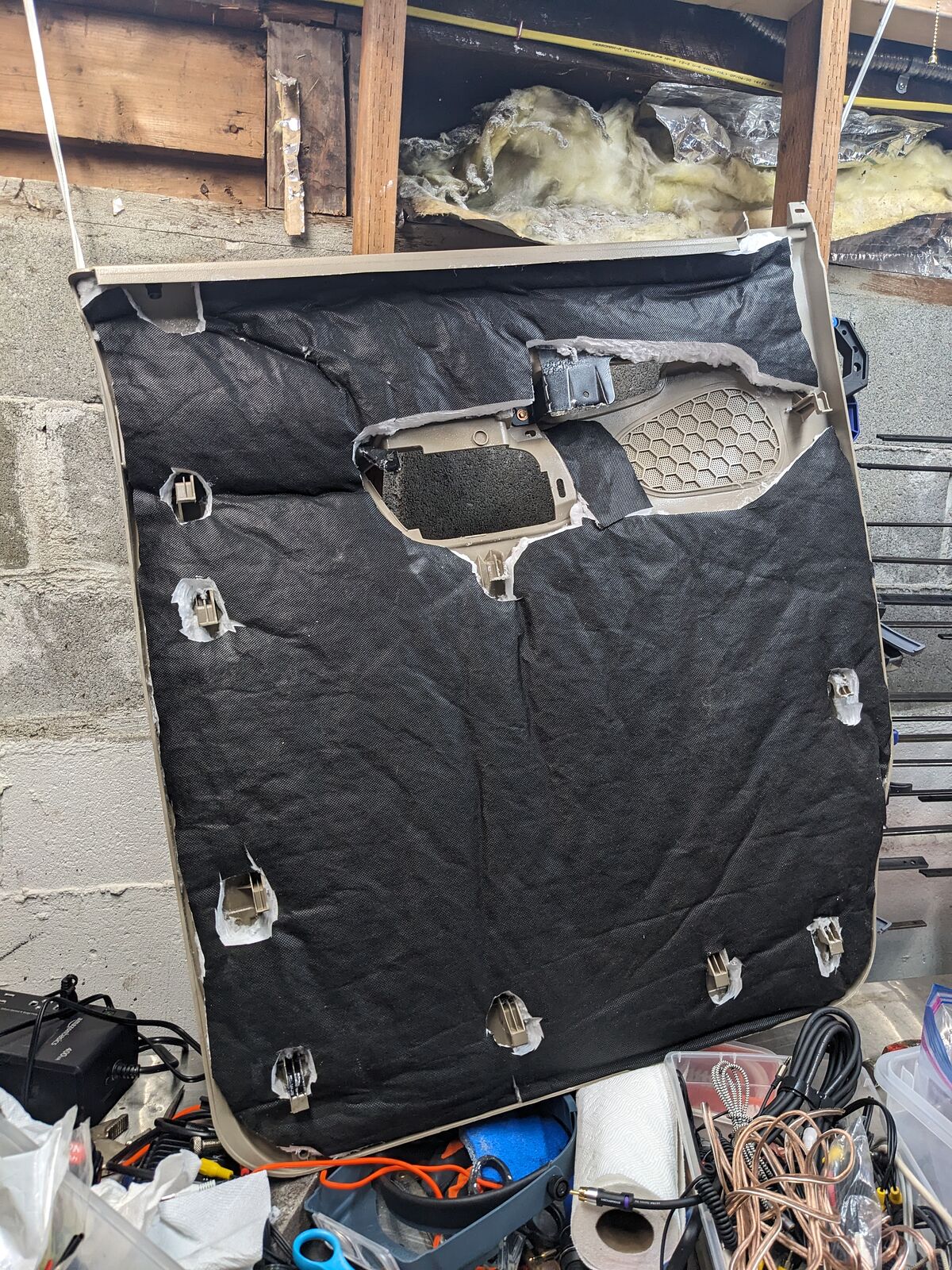

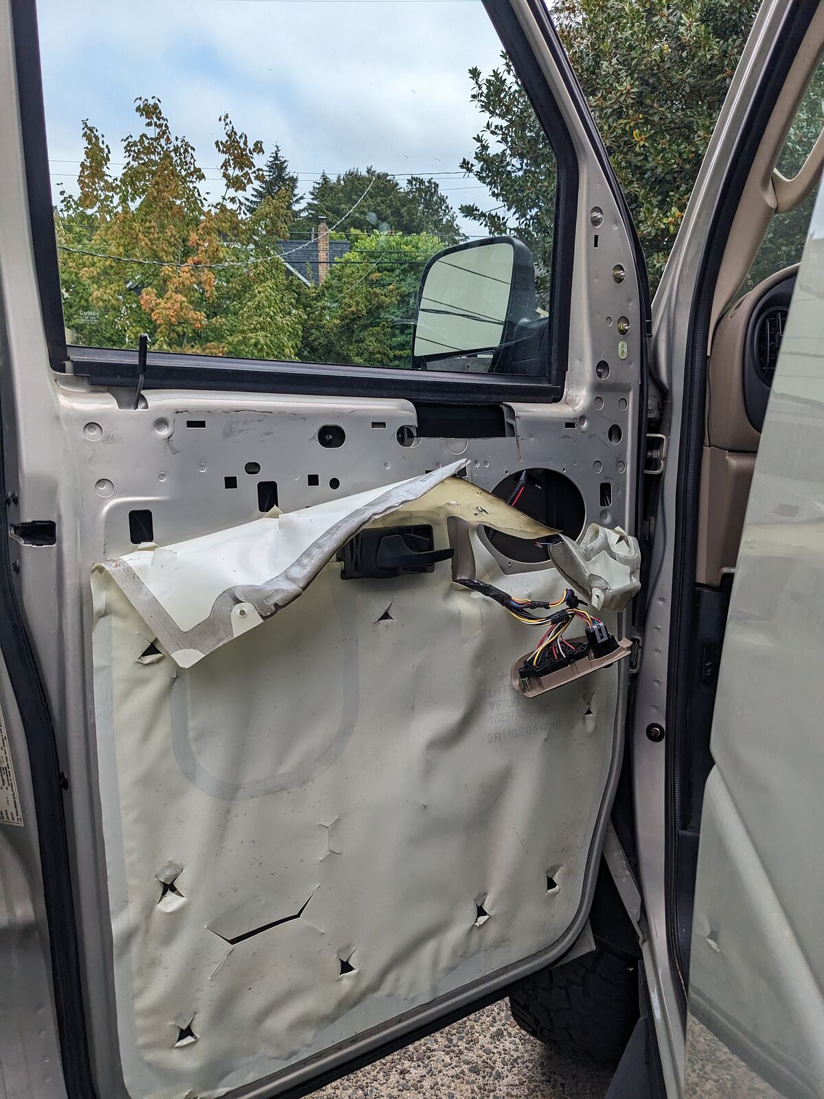

I did end up insulating my driver and passenger doors, as well as the inside door steps (under the plastic covers).
I stuck butyl sound deadening (RAAMmat BXT) to the inside of the outer sheet metal, and then glued Thinsulate to the backsides of the door panels (using 3M Super 77 adhesive). Getting the door panels back onto the doors with that Thinsulate in there was tricky, but after *lots* of fiddling I finally successfully got them back in place. The trick is to get the bottom four clips attached before working on the other four.
I wasn't expecting much ... but wow! This actually noticeably reduced the highway road noise! I wish I had taken dB readings before and after, but I can now have a quiet conversation with my passenger, and I don't feel like reaching for my earplugs when driving alone anymore.
