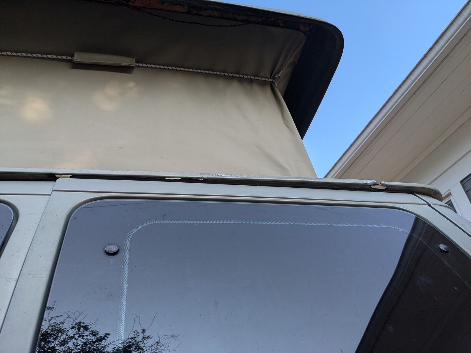

I'd like to repair a few spots on the drip rail along the left and right edges of our 2014 E350 where the PO had clamped down some bike racks really hard. It could rust and so I'd like to patch it up so it doesn't become a problem. This van will eventually have a ph top so no need to clamp anything on the rails. But since this area is where water winds up I think good idea to address it.
A body shop guy thought the rubbery material in those channels at the edge of the roof was seam sealer. Is patching these spots with seam sealer and touch up paint the best way to go? I've never worked with it.

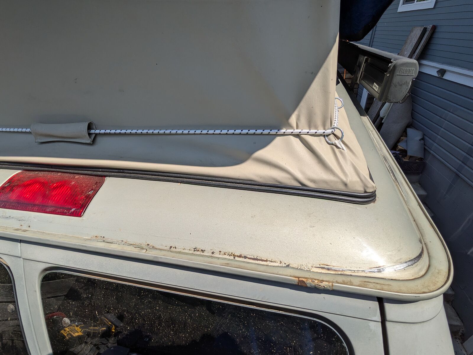

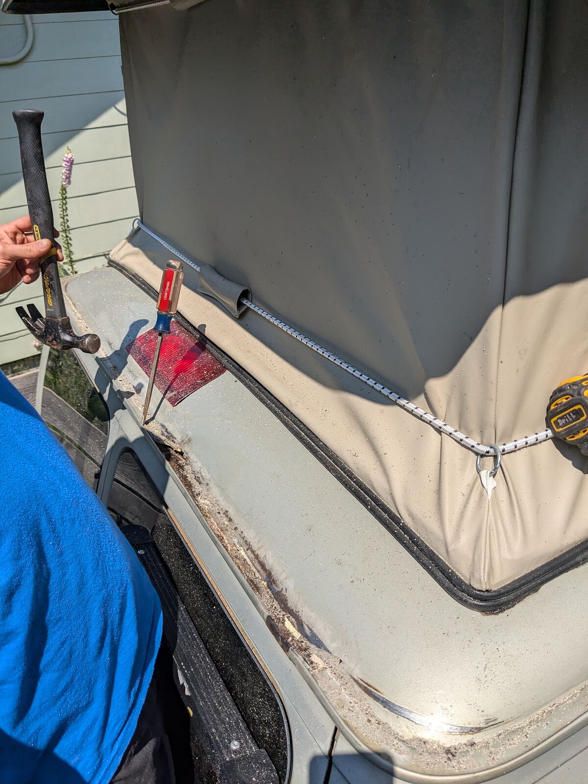

I fixed my gutters / drip rails. My seam sealer was cracked along most of the rail.
The rear rail had really deep cracks and some rust showing through. Chiseling out the existing seam sealer revealed more rust. In some parts I ended up with holes all the way through the sheet metal.
(I also took this opportunity to repair the roof wear-through caused by the rubbing penthouse top.)
I had my best luck removing the old seam sealer when using a hammer and flathead screwdriver to chisel it out. I also used a wire wheel, and my angle grinder flap wheel. I only did this with the rear gutter -- the others weren't rusty yet.

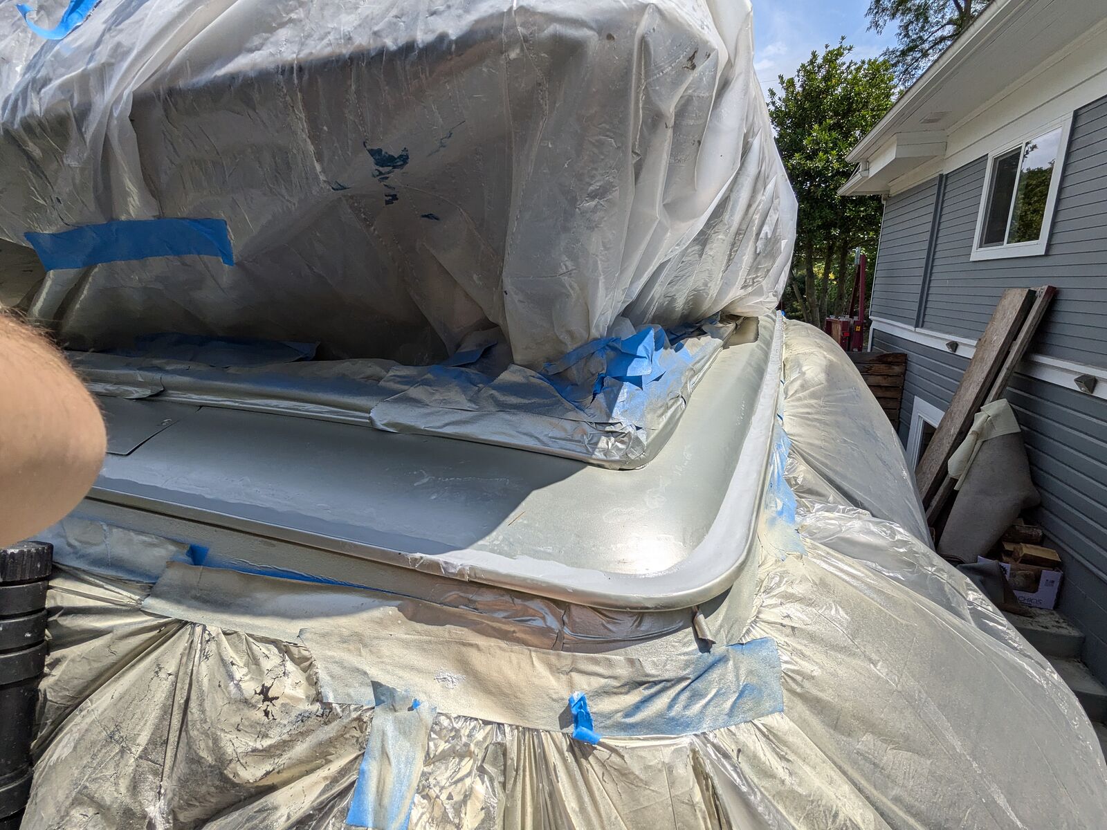

Any remaining rust I coated with Ospho, then primer and paint.
Rather than using seam sealer, I took 86Scotty's approach and filled them with Tremco Vulkem 116. It is very messy to work with, but I had acetone on hand to wipe up spills. I read about the trick of using a gloved finger coated with soapy water to smooth out the Vulkem -- worked great! -- but I had mixed feelings about using water in an application where I'm trying to avoid rust.
I refilled the rear gutter with Vulkem (replacing the removed seam sealer), and also used it to fill the cracks in the side gutters. To fill the rust-through holes, I just used Vulkem -- I didn't bother trying to weld in new metal.
I didn't bother sanding my angle-grinder marks in the roof smooth before painting. I don't care all that much about aesthetics. Also -- these areas will soon be hidden by Avery UHA tape -- so my penthouse top doesn't wear through the paint again.
