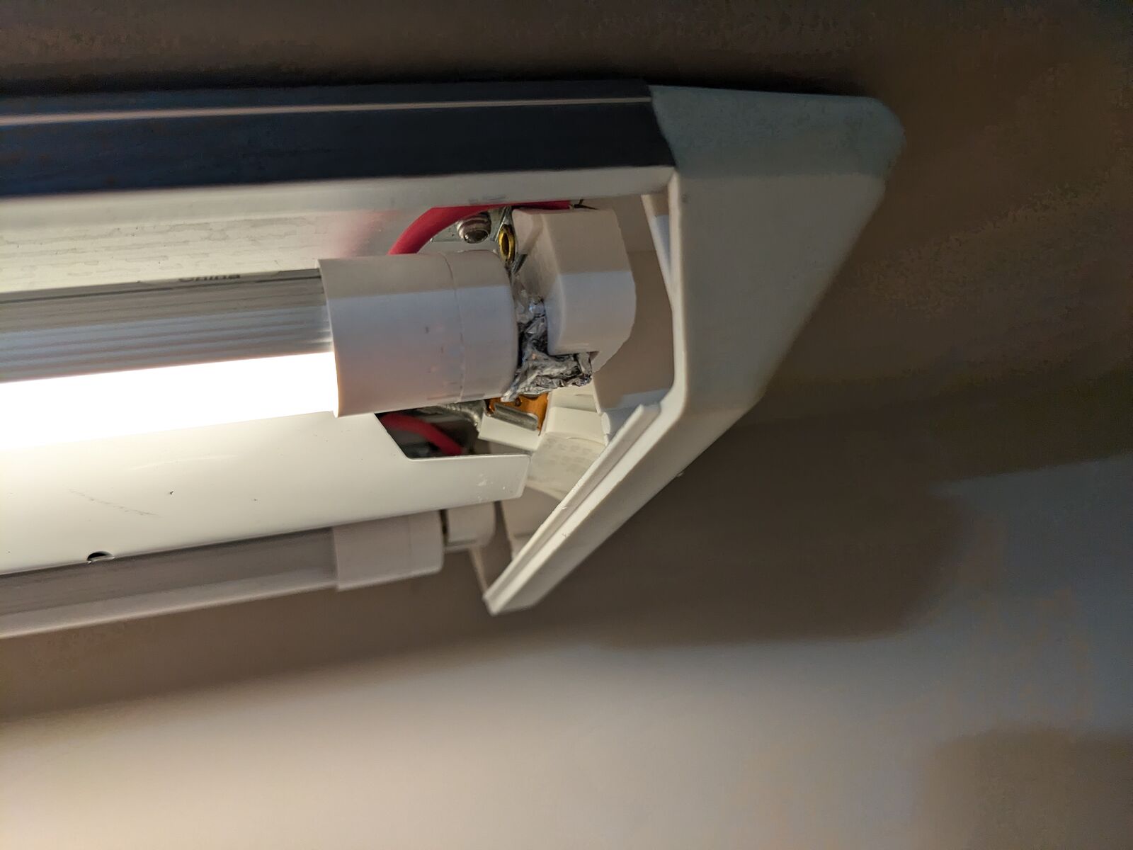

More deja vu work in my "new van".... Here I am replacing my fluorescent tubes with LEDs, again.
This van has two sizes of fluorescent tubes:
  • F15T8: 18-inch T8 tubes for the ceiling lights
  • F8T5: 12-inch T5 tubes above the kitchen counter
Replacing the F15T8 ceiling lights was easy. I used Amazon.com The contact pins on the ends of these LED tubes can be rotated so the light shines where you like.

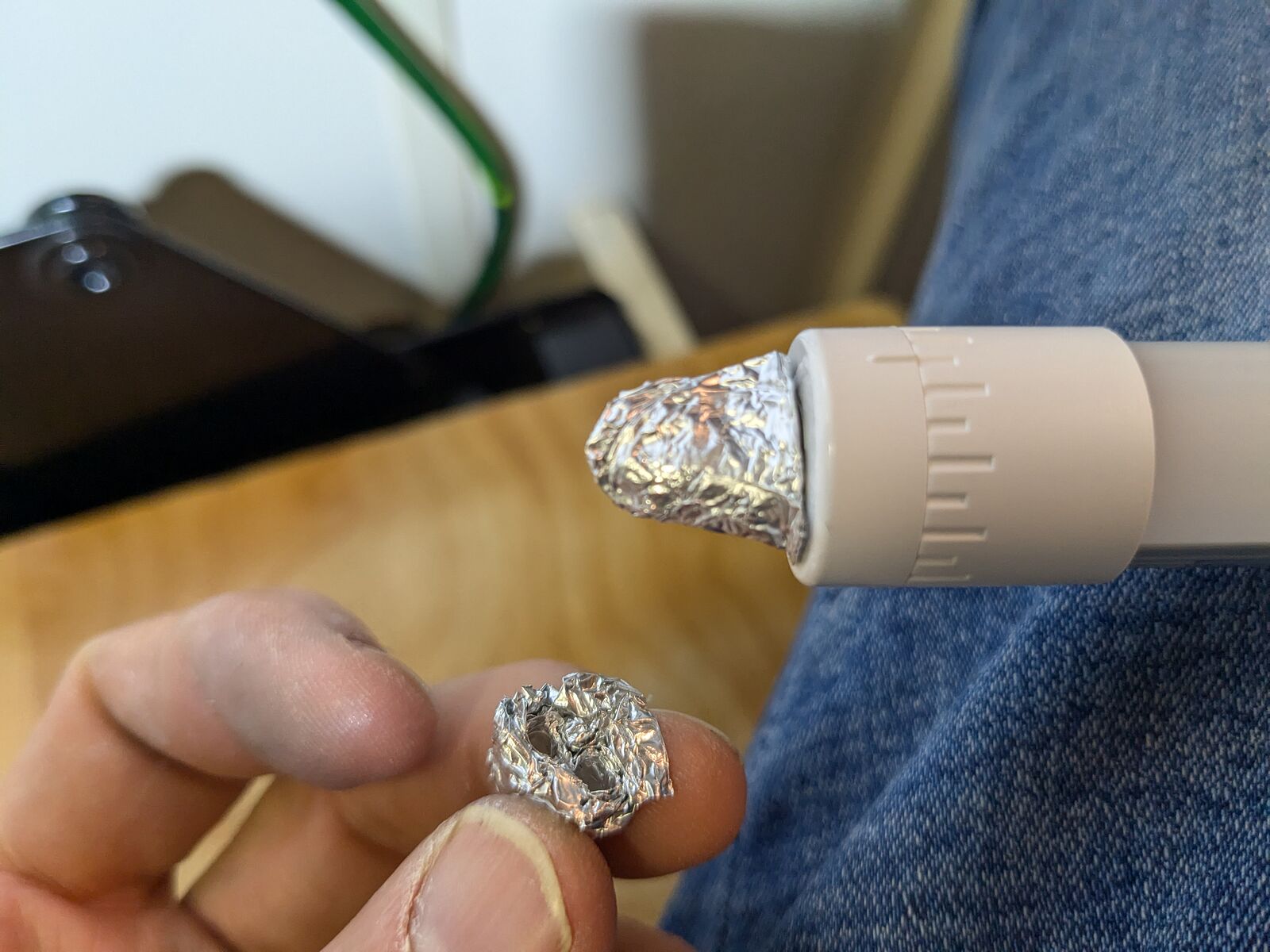

Replacing the F8T5 countertop lights was trickier. It turns out fluorescent bulbs vary in length. F8T5 tube bulbs have a "nominal size" of 12 inches, but some are actually 11⅞" long, and some are only 11¾". It turns out that my fixtures are a full 12 inches in length, but the LED replacements Amazon.com are only 11¾" long. (I couldn't find any 12V LED replacements that were a full 12" long.)
I eventually came up with the idea of wrapping the contact pins with aluminum foil in order to buy myself another ⅛" on each end. It works amazingly well! The wads of foil make those bulbs stick in their fixtures nice and secure -- no wiggling at all.
modified wiring: ballast removed
LED (left) vs fluorescent (right)
aluminum foil to the rescue

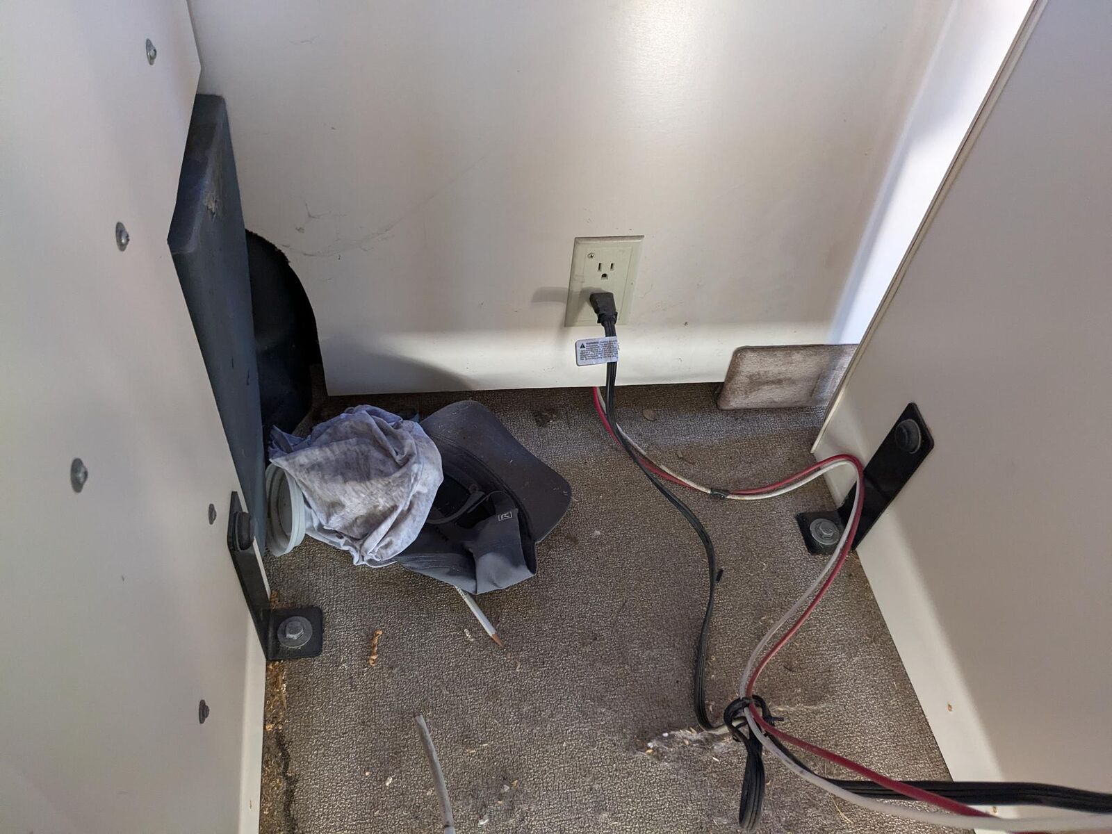

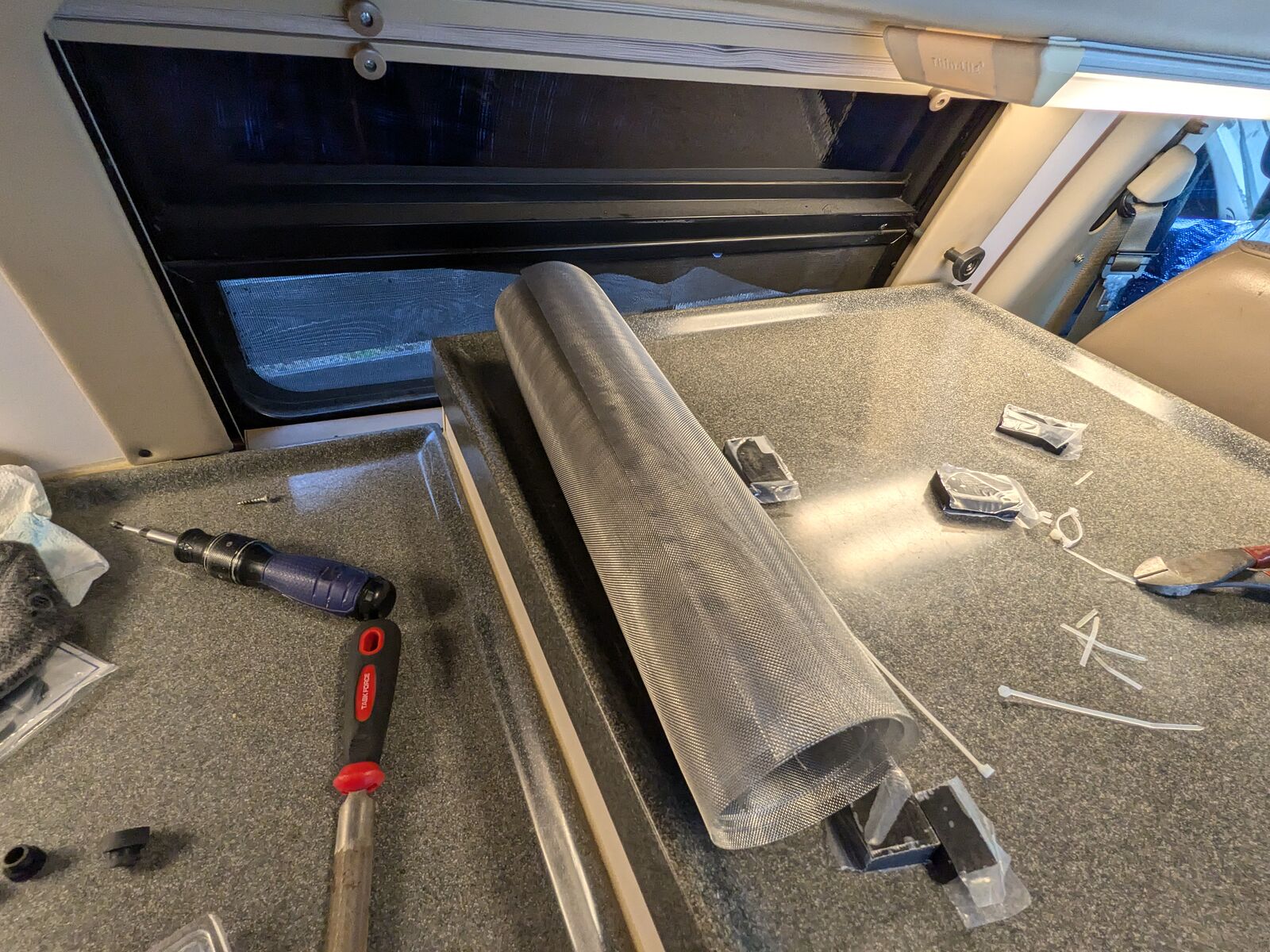

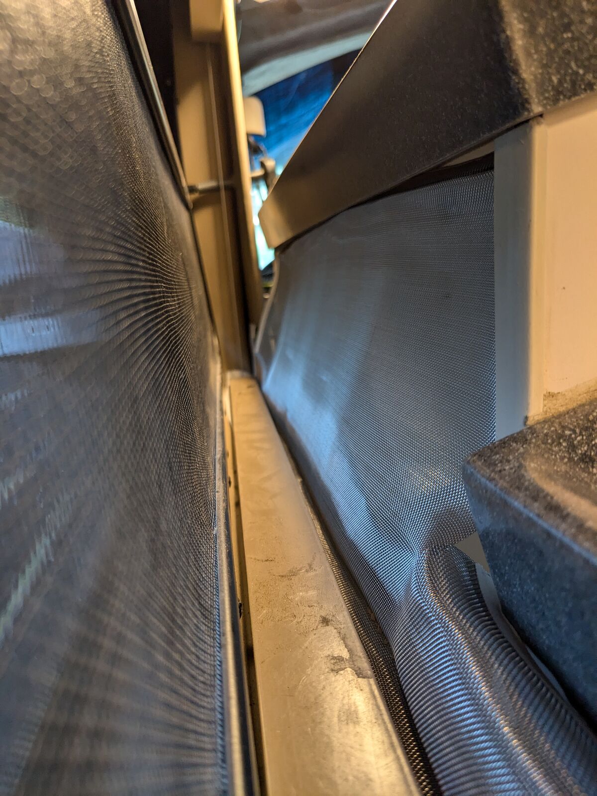

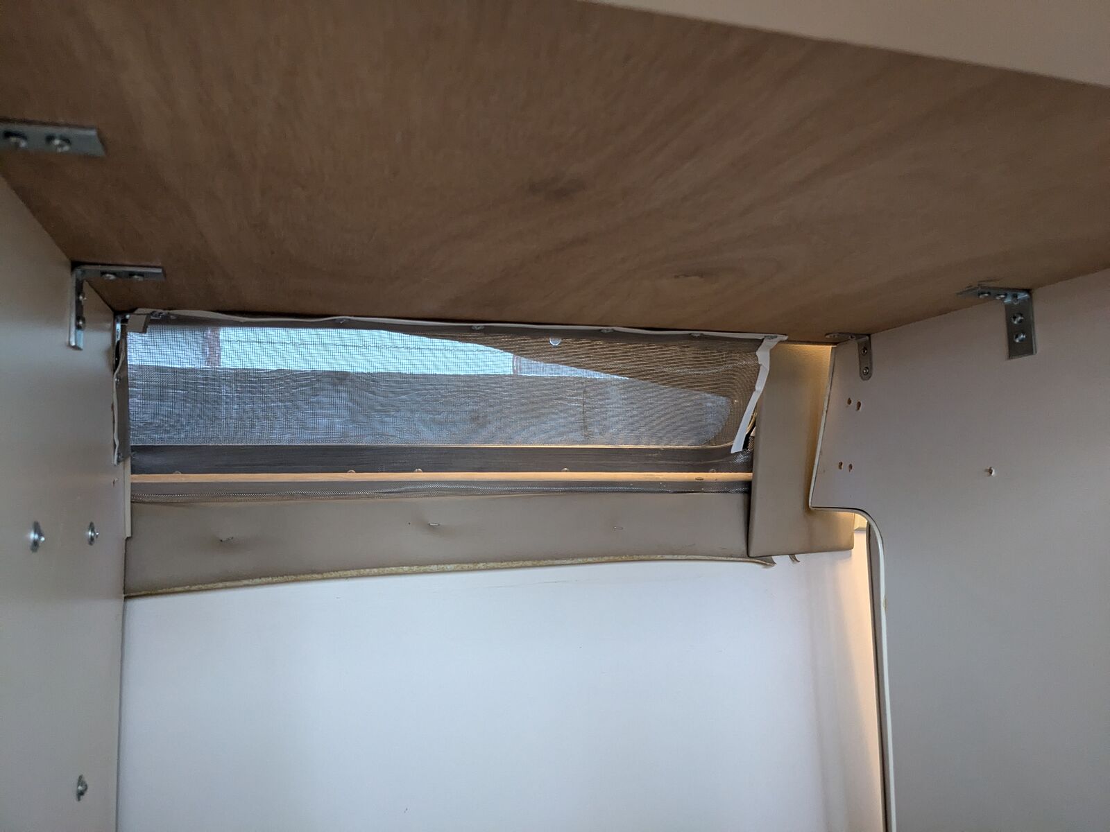

My van has this black hole. If you push things on the kitchen counter back towards the wall, they will fall off the edge, down into a giant crack, to be forever lost behind the refrigerator.
I had the fridge out (for reasons I'll describe elsewhere), and found back there 20 years of lost stuff -- including a pair of prescription eyeglasses, some hats, a shirt, and various other miscellaneous little things.

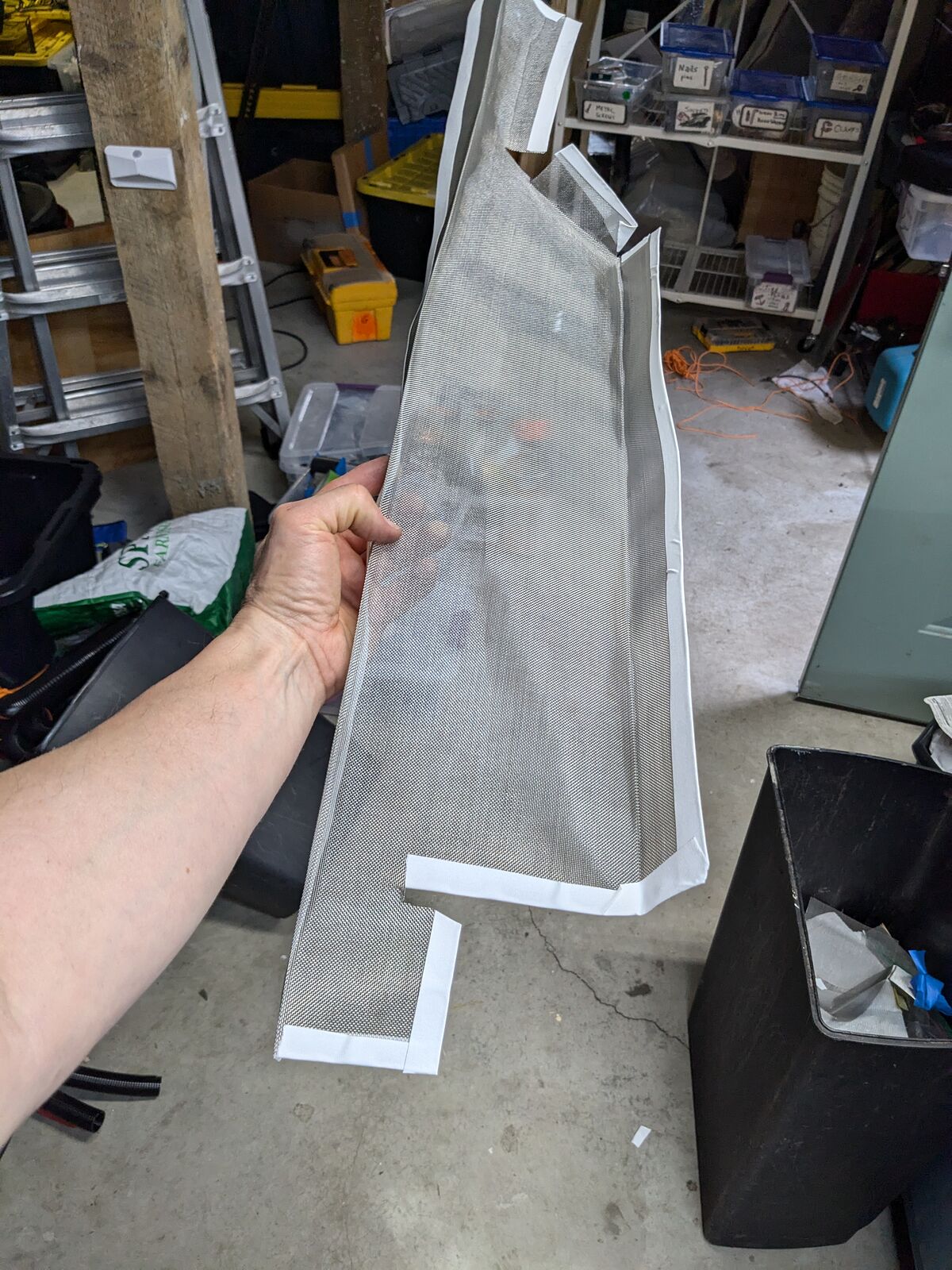

I decided to block this gap with some screen. (I don't want to block the airflow to the fridge.)
I cut this shape, and screwed it in back there.
Phew!

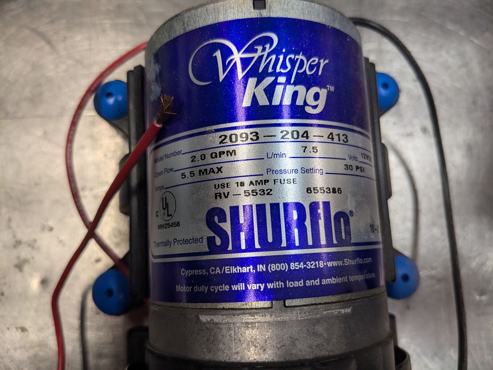

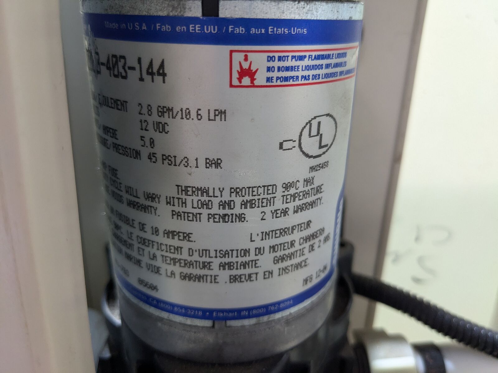

Replaced the originally-installed Shurflo 2088-403-144 water pump with a Shurflo "Whisper King" 2093-204-413. So much quieter!!

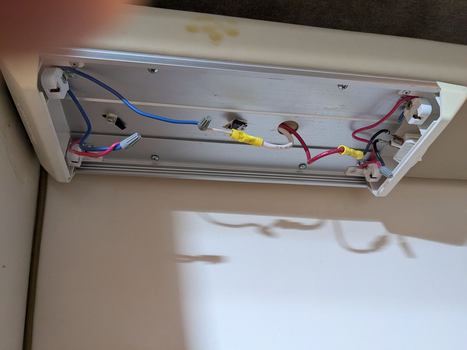

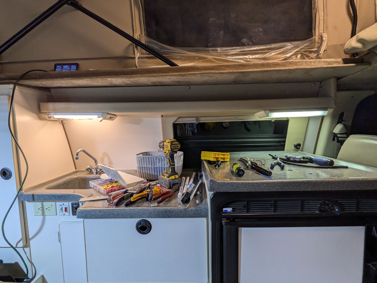

So the interior lighting finally got on my last nerve. The original bar type lights were suffering bulb failures and I couldn't find new bulbs, and the reading lamps were similarly falling apart, including the one behind the drivers head that kept leaving a dent in my dome I have had it with these fixtures!
So I spent some time out in the HEAT working on the swap until I ran out of daylight. Kind of hard to work on lighting with the power disconnected in the dark after all.
I have 3 of these lights out of the 4 installed and they are nicer than they have any right to be...
Amazon.com
One over each cargo door so basically one by the rear cargo doors by the bed, the other by the slider at the kitchen, and then one on the far side of the Penthouse top (Sportsmobile calls their pop up top a Penthouse roof). The one at the front of the Penthouse roof needs to be done.
And I have 2 of these lights out of 3 installed. Amazon.com I bought the single pack and a two pack since there is no 3 pack...
The one at the end of the bed by the kitchen is the one I had wired wrong. The black wire was the HOT wire NOT the ground... Fixed it and it works GREAT...
The other ones go one on the other side of the bed kind of crammed in between the closet and the rear window by the bed, and one goes RIGHT BEHIND the drivers seat behind the drivers head. They have USB charging ports and are touch controlled with dimmable lights.
The splices are heat shrunk as well so they should be there a good long time.
Once all are in I will take video of the whole setup and process / publish a walk through of the lighting. If these things prove reliable, I don't think there is any way I could be happier with them...
I will get back after it and get the fixture at the front of the Penthouse top and the one behind the drivers seat swapped, get the battery hooked back up and test it all out tonight after I am done talking with my GF and she has to get to her extended family stuff...
