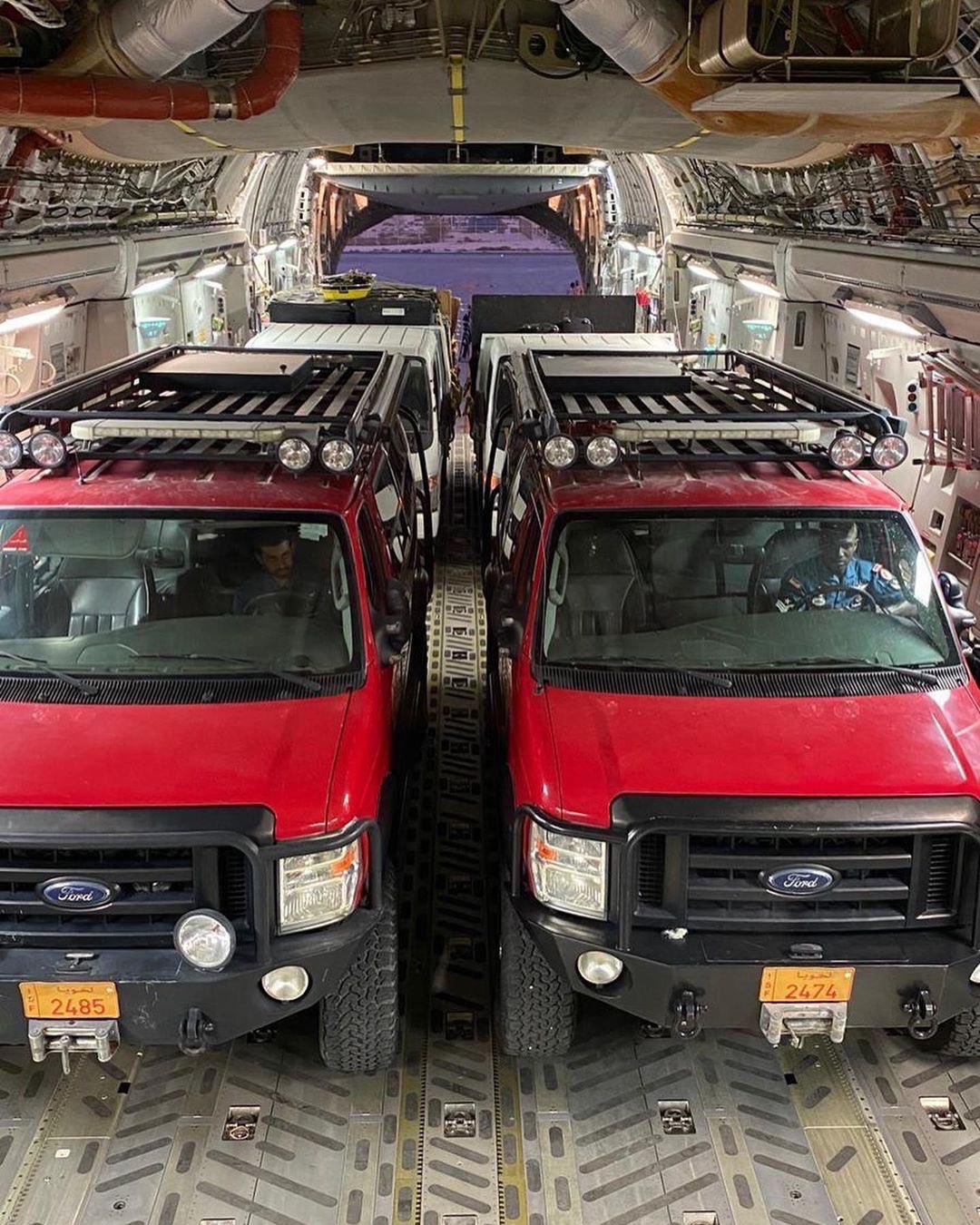

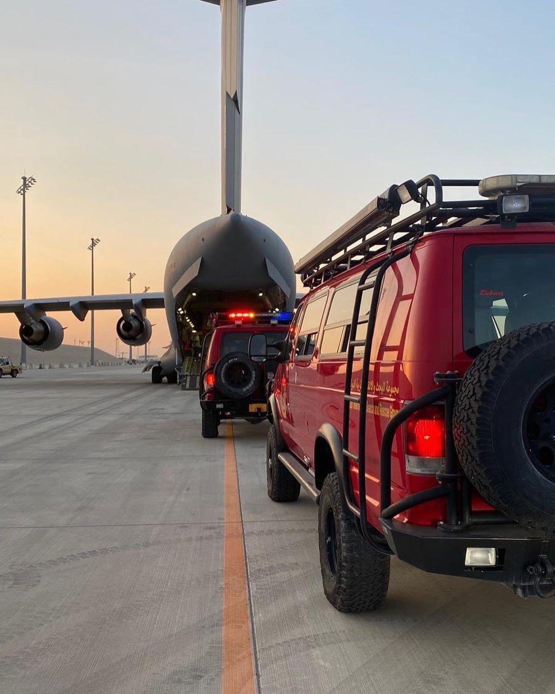

I bought a 2008 Ford E350 sportsmobile
I don't know what type of brakes pads is right for my car.

@khalidalajm: Great looking Van. It may just be the quality of the pic when I enlarge it, but your initial post states you have a Sportsmobile…and from the picture it looks like you have to roof rack mounted to the roof drip rail (so I’m guessing no pop-top???). Did Sportsmobile do the actual 4x4 conversion or do you have a well dressed Quigley 4x4?​
If it’s a Quigley you can contact them and request a copy of the build by providing your VIN number. At least then you’ll have all the specifics if you ever need it - I’ve seen a couple of these reports but honestly just don’t recall if the brake pad’s were listed with the rest.

This is an original SPORTSMOBILE but the roof is not high. It was a search and rescue vehicle, only 11,000 miles. I bought it a year ago. It had an engine failure and I replaced the engine and now everything is fine. I am only looking for consumables because this is the only car in my country.

That is indeed a sweet looking rig and congrats on the purchase! Year and VIN will help pin down which brake pads you need. It looks like you have 17" wheels so that could be either the smaller rotors/calipers or bigger ones.
I believe that generally in the earlier years Sportsmobile was mainly using 16" wheels. But when Ford went to the bigger brakes that size wheel won't clear calipers with a 14.5" rotor.

At first glance this looks like the 4x4 conversion was done by Sportsmobile, but I'd need better photos of the front wheel well area to be sure.
