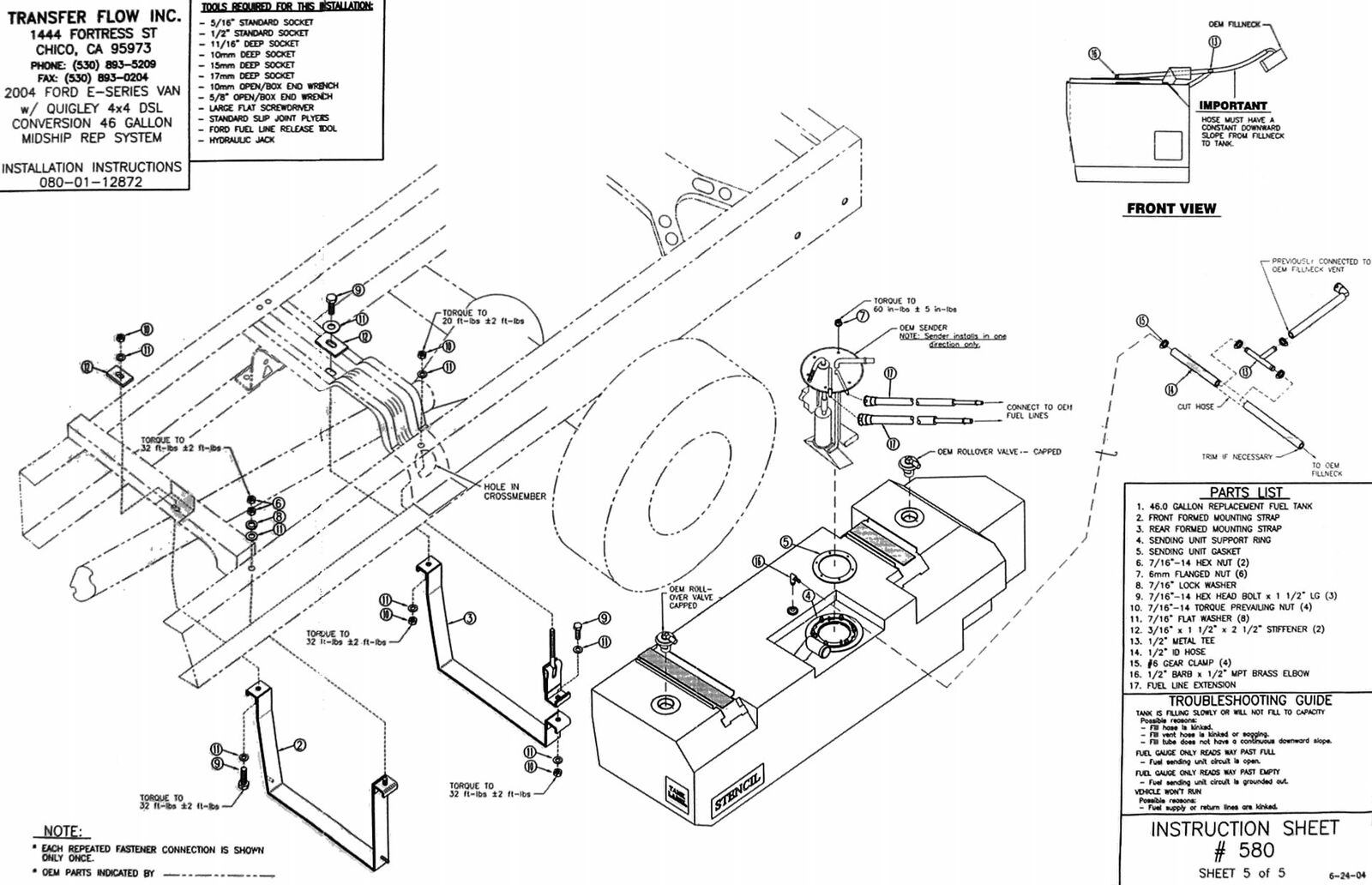

Whatever you do KEEP THE TRANSFERFLOW 46 Gas tank!!! Use it another van or sell it
Probably wise! Though it means I can't use my old van while my new one is being built, and selling or moving the remaining van might be tricky without a tank.
I think the stock Ford tank won't fit with the transfer case in there. (At least that's the case for a U-Joint 4x4.)
Anyone know if Transfer Flow still makes 46-gallon tanks for the E-Series?
They only ever made them to order for SMB and Quadvan Never available retail. Now I do not think they are making them at all.
Wow! That explains things. OK I'll never give mine up :)
Here is a Transfer Flow "prototype" I saw behind the Quadvan building!
Wow, pretty amazing pics of the prototype.
That reminds me somewhere in my "stuff" I have (or at least used to have) an actual drawing set of the TF 46 Tank. No clue as to how I got it.
